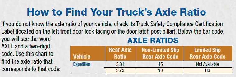

Prolly the 2WD, less weight and rolling resistance. E85 or E88 should lower the MPG, in exchange for the lower price of the fuel. I'm thinking you have a 3.31 rear gear, but if you ever want to know for any reason, just follow the information below.

Prior to 2018 model year the HD tow package came standard on Limited and above models and did not dictate axle ratio. In order to get HD tow on 2018 and newer you needed option package 536 which included the 3:73 axle ratio with eLSD. My 2017 Limited HD Tow came with 3:31 open rear, tows great and as stated above gets decent mileage doing it.
