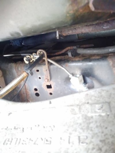

I have done a little searching through the forum and found another inline tube installation and think I have found my problem with the line. The line I have appears to attach to a junction block. Pictures courtesy of Lee_H and BrandonK4204 show the block and line layout of the cross over. However, by 2003 EB does not have the block from the factory, runs two independent lines back, one goes to a cross over and the other feeds the driver rear directly. Has anyone else bought an inline kit that did not use the junction block for cross over?

I have the shop manuals and did the point to point checks a couple of times. Gave up, took it to the dealer, they could not find a connector or ground problem either. Suggested replacing the module. Obviously, that didn't work. The module works and sends messages, I can reset the advance track light and even turn Advance track on an off. No ABS problems. So, something is not working right.
As for the brake lines, I am working with Tech Support at inline tubing. They actually seem pretty good. I have on line from that goes from the rail connector to the cross over to the right rear. They are looking to see if they can find a bend diagram. If not, it is a simple fix to determine the line length, have them send me a line with connectors, and bend it on installation. No complex bends, just over the rail to the connector.

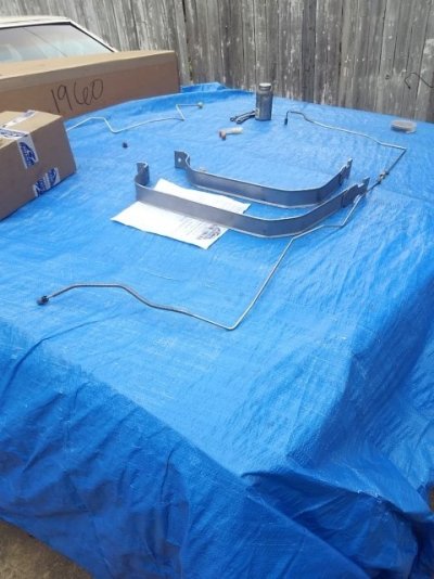

Inline kit was $215 shipped to my door in about 3 days. 14 lines with additional breaks to make installation easier. Stainless steel lines and easy to work with. Other people on the forum have used it.

Progress update. I have all the brake lines installed. InLine Tubing sent me a tube for the missing line. Inline Tech support was helpful, and the line was shipped to me for free. Unusual these days to find a company that will help. Not really their fault, my 2003 is in the transition from Gen 1 to Gen 2. I have run into configuration problems before. Bent the tube and all is in place. I did have to rebuild one end of a kit tubes and modify it to take a union instead of the Female connector they had. I think it mated a bubble into a flare, I didn't like that, so I just set up flares into the union. I will bleed and leak check this weekend and the reassemble.
