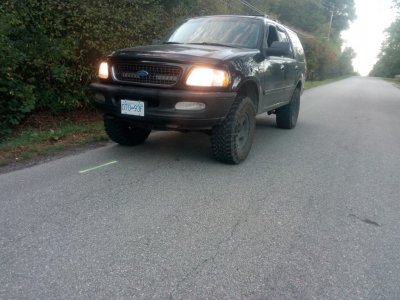

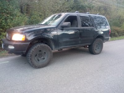

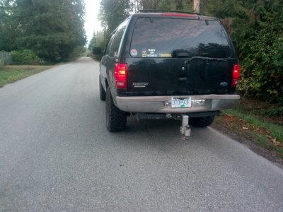

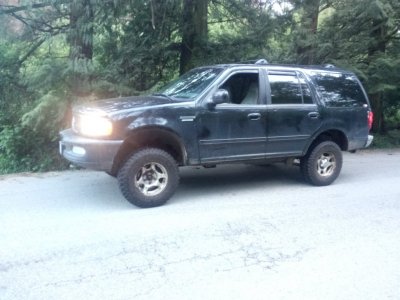

Since late summer.
How she sat with just torsion keys cranked and rear spacer, before body lift and 37's.
