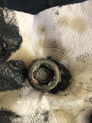

Undo the fill plug at the top then the drain plug at the bottom. Reinstall drain plug. Buy the hand pump that fits the larger top amsoil bottles. The Ford friction modifier bottle is small enough to just put up to the fill hole and squeeze.
Factory uses red thread sealer on the plugs. I was unaware of this and buggered up the plug trying to get them off.
Heat them up with a torch and they will come right off and you won’t need to replace the plugs like I did. Though they are cheap if you just want to buy new ones in case.
You can see where I buggered that one up.

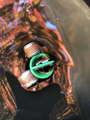

Curious - what is the green plug in the fluid?
PS - What part of Kentucky? A family member lives near Burnside (Lake Cumberland area) and the road to their home had been blocked by flood waters, since last Monday. They’re at the end of a dead-end county road, and can’t get out other than by boat.
That is the plug for my oil catch pan. It has a tab inside the pan so it just unscrews but actually can’t be fully removed so one does not loose it.
