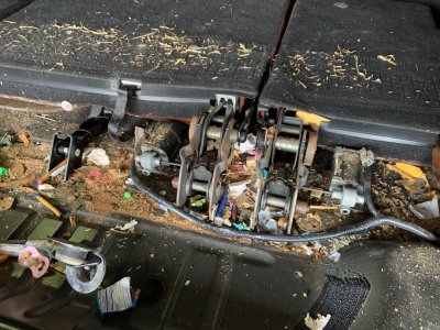

After buying this 08 Expedition I could see signs of mice having been inside it. Not unusual here in farm country. I pulled both quarter panel interior trims today to clean behind and check wires for damage from mice. They had shredded a lot of the insulation and I’ve vacuumed out all of it. I was about to put the right trim panel back on and thought first I might as well pull the fan and clean it. This is what I found. The previous owner has 5 kids and this was blowing in their faces.
I know removing these panels isn’t any easy job, but seriously this stuff needs cleaning. The fan motor would have probably burned out.

Yeah, if you have a vehicle that lives on a farm, it's definitely a job worth doing ! What is all that debris? What a mess !

It is the foam backing the mice chewed off the rubber sound deadening pad that cover the wheel well and most of the quarter panel. The left side I completely removed the subwoofer and the pad to vacuum and wipe down. But the right side, I’m not disconnecting the hvac. I just poked around under and behind the pad best I could with shop vac. Once I had it vacuumed, I took cordless leaf blower and blew out the hvac and overhead ducts.
