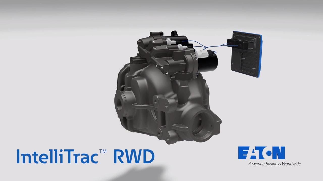

Several statements in this Thread that need correction and clarification. This has been discussed and clarified in this Forum SO many times. I really should make a Sticky for this.
Clarify terms and the differences:
ELSD - Electronic Limited Slip Differential. It is Electric Motor based clutches. It never Locks. It has a simulated lock mode that uses the clutches, but can fail under extreme use and default to open. Advantages over a mechanical LSD, is speed, and the ability for the computer to preemptively engage it based on other sensors.
ELD - Electronic Locking Differential. Electronic Pin locked differential. Both sides spin the same speed. Either operates as a solid, or an open differential, and has ZERO function as limited slip. Modern F150's and F250's have this as an option, and not the ELSD. It appears the 2025+ Tremor Expedition might have this instead of the ELSD, because of its advantages off road, and not to have the overheat issues again when off road.
If your Expedition is equipped with the ELSD, it is ALWAYS active, EVEN when TC or AdvanceTrac are off, just like a standard mechanical LSD would be. The button on the console, does not turn ELSD on and off, it turns simulated Lock on and off. It only should be used when you need absolute traction, and should not be used on dry pavement, if you are going to be turning(I used it to get my best 0-60). It will overheat the clutches and can cause issues if used on dry pavement when turning.
The standard LSD in the 15-17 Expedition was flaky, and if not maintained just right could have issues. The ELSD was night and day different in the 4th Gens. It made these big beasts way more sure footed than they should be even in 2WD. I assume the ELSD is going to continue as a option or standard in the 5th gen, but I can't see any stickers to confirm that.
I wish from a daily drive standpoint that my 150 had the ELSD, but when I am Off Road on a back trail climbing a rock ledge, I am glad I have the ELD.
Also, clarity, the ELSD sends torque to where it is needed under normal conditions. It doesn't just "lock" when it senses spin. It will use the clutches to drive the outside wheel faster to help with rotation if Advancetrac senses it is needed. It can apply torque separate to each wheel. It is an LSD, with SO many advantages.

Here is the exact unit used in the Expedition.
