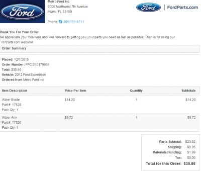

In case anyone else needs them, these are the parts I found for this mod:
1x W708312-S441 NEW FORD NUT - HEX.
1x 9L1Z-17C526-B NEW FORD OEM COVER
1x 9L1Z-17528-B NEW FORD OEM BLADE ASY - WIPER
1x 9L1Z-17526-A NEW FORD OEM ARM ASY - WIPER
Im not sure if the hex nut is required but I ordered it anyway. With shipping it was $36 from fordpartsoem.net

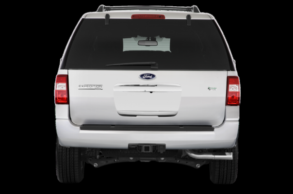

page 2 has the pic i posted in this thread...they are below again...i bought the arm and i bought the wiper...the wiper has the blade already on it...pop the cover...take off nut...you can pre-assemble the wiper and arm before putting on and put the nut back on...DONE

youre getting rid of the awful looking old style rear wiper arm/blade for the 3rd gen updated style...cleaner look...sleaker

Did this yesterday. So much better.
My old wiper arm was stuck in the 'almost touching the window' position. The new arm looks much better too.
Anyone have the issue with the blade not contacting the window in the dead center of the blade, with the 2010+ arm?
