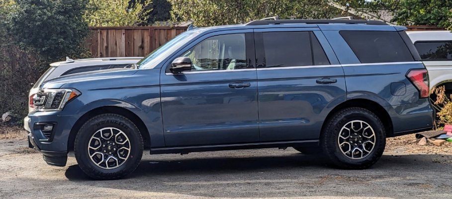

I wouldn't go larger than the 265/60R18's. Particularly if you'll tow or otherwise load the back down. I'll tow with around 600 lbs tongue weight. I'll add the Sumo Coil adapters shortly...

If I add the Bilstein 5100’s could I get away with 285/70/18 with no rubbing?
Anyone out there with that setup ?

the standard size on a 18" expedition is 275/65R18 (not counting special versions) I've run these about a year and a half, and 15000 miles or so and am quite happy. still running the stock tires that came on a Ford F150 FX4 or whatever circa 2023. 35 PSI is the recommended tire pressure for this combination.
