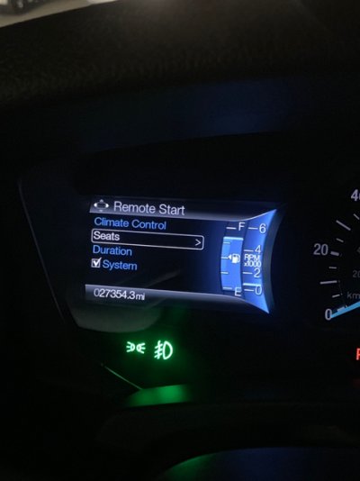

My wife has a 2016 Expy Limited and complains her seat heaters don't activate with remote start when it is cold. Looked in manual and searched forum with not much success. Any thoughts?

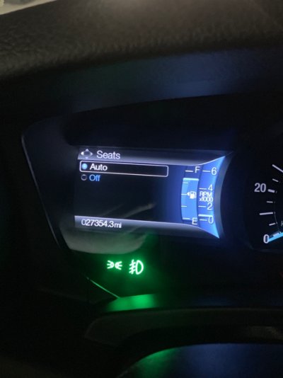

Interesting. Wonder why? Found an 'auto' setting in advanced settings. We will see what that does.

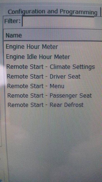

There are options in forscan as well. How does the heat work for you on the factory activated remote start?

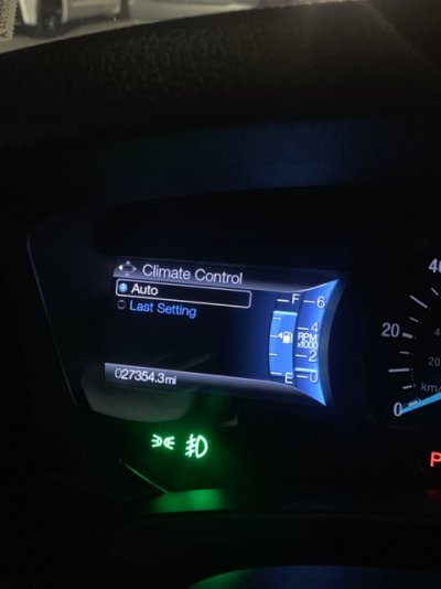

Set the Auto Setting like you found. If you have cooled they will cool when AC runs. They will heat when Heat runs...
Climate Setting under Remote Start must be set to Auto also.
