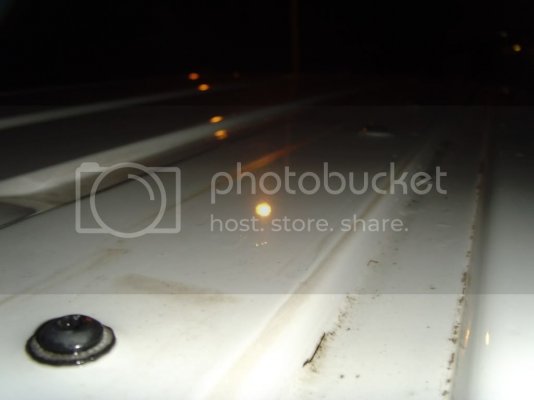

On mine, they were held by Torx screws (I think they were T20s). I think there's 4-5 per side.
This is what my roof looks like with the racks removed:
Yes, if you don't put the screws back in, there will be holes.

hey elvato i just took mine off thanks for your help but did you put teflon tape or anything like that back around the screws because im a little worried about leaks or did you just put the screws back in? thanks
ELVATO
Nov 25, 2006
2,634
34
Orlando, FL
I just put the screws back on. I think the little black things are little washers, or something.
Then again, I'm sure the Teflon tape wouldn't hurt.
