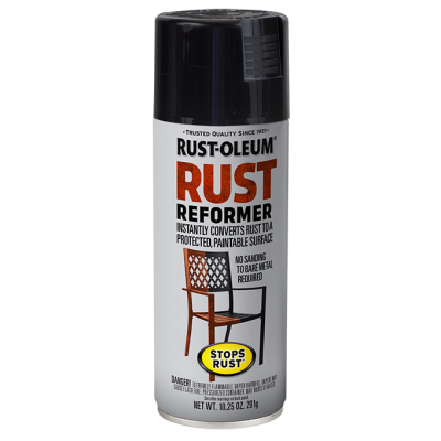

Do you have a Dremel tool ? Use it and a small wire brush to get rid of as much as possible, then spray it with some Rustoleum Reformer to treat the metal, then spray it with some Rustoleum gloss acrylic enamel (Automotive quality) in whatever color you need. You can find it at any Home Cheapo. It's very common on all Expeditions / Navigators / F-trucks . Ford didn't use any galvanized metal on the roof panels, and they are very prone to rusting in the low areas. It's just something you have to keep an eye on, and treat it when necessary. Check the metal between the hinges on the rear hatch too. Really anything related to the roof panel. I found big rust holes under the roof racks.
