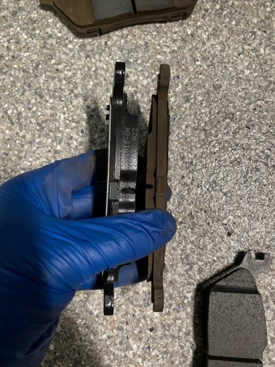

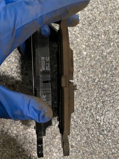

I didn't have time to be picky, so I just went with the painted Carquest rotors from Advance Auto and the Carquest Gold pads:Hi - what brand / model of pad and rotor did you go with? Thanks!

I just ordered the rear rotors and pads from AAP. The guy said the pads are from Akebono. $210 with coupon and I'm looking to install them this week.I didn't have time to be picky, so I just went with the painted Carquest rotors from Advance Auto and the Carquest Gold pads:
So far, so good.
