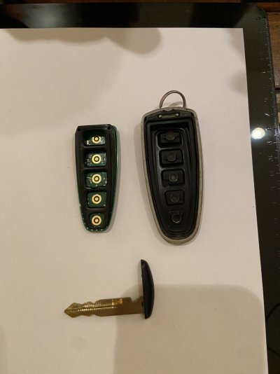

You guys were spot on when suggesting it may be the key fob. It was. After keeping the suspect fob in a faraday bag for two days and having the issue disappear, I decided to investigate a little further.
First, I opened up the key fob. That told the story, instantly.
A better close up -
Any guesses as to what that second button from the top is that looks different than the others? It's the lift gate button, of course. The contact pad had dislodged - that's the metallic disc you see between the second and third button, near the right hand side. I took some time and cleaned all the contacts on the board, re-positioned the dislodged disc, and centered all the discs.
No more phantom random liftgate openings. Just another thank you to the folks that suggested the key fob - I was so focused on the truck that the fob never really crossed my mind. I hope this helps someone in the future!
