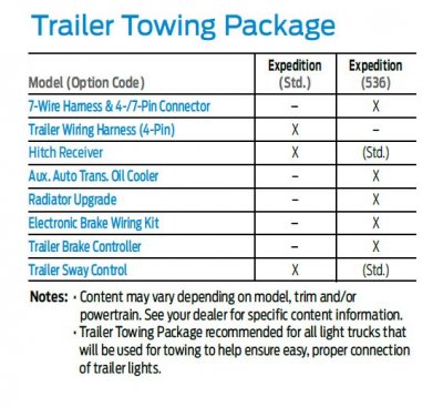

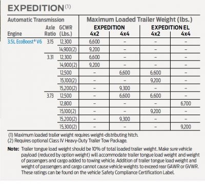

Can or should? I wouldn't tell you to tow more than what it's rated for. With my 07 however I was loaded pretty heavy the below trip and my 17 would have towed it much better. It also wasn't balanced correctly. Below that are the standard towing specs for the 17 Expys.
