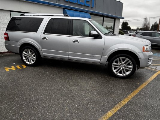

Hello everyone,
Has anyone put a set of 2022 and newer expedition rims on a 3rd gen?
I just got this platinum 2017 el with 85,000 miles and the stock 22 inch rims are pretty chewed up.
It has brand new 22 inch grabber tires and thought I could put some brand new 22 inch rims from a 2022 model on this.
Any thoughts ?
Thanks in advance
Loving this new vehicle, came from a 2018 explorerIMG_4822.jpegScreenshot 2026-01-06 at 7.44.30 AM.png
