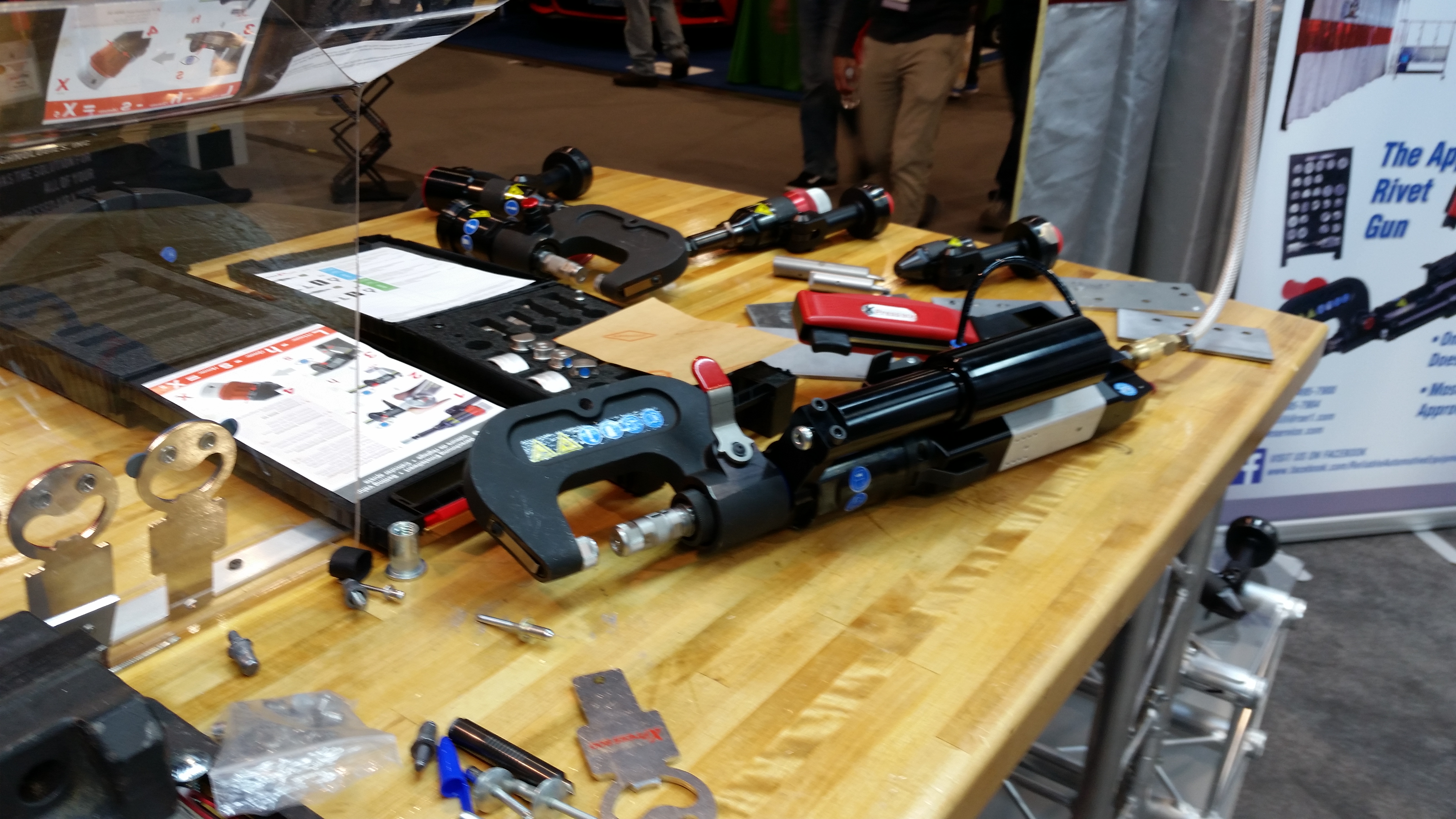

An article including Ford's statement about its use of Self Piercing Rivets in new car construction and its recommended equipment for their repair:

I humbly stand corrected, but still cannot fathom why the spot welds show on the inner panels with the interior roof trim removed on the vehicles I posted about earlier.
