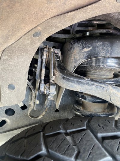

Looks much better replacing the rear links.

I just had my 18 Platinum lifted 3”. The RC kit doesn’t work with the CCD. The shop told me it’s bc there is no bracket to mount the sensors. It was shown to me that the sensor is mounted to the UCA. Would you guys confirm this for me? So I ended up with Spacers from Ready lift. Thanks in advanceI looked at the list of all the included pieces. The front are two loaded strut assemblies and upper control arms. So in the front, the lift is with the strut assembly instead of a spacer. The rear lift is by spacer.
This could possibly work with CCD if front spacers are used with the OEM CCD strut assemblies, front sensor brackets, and adjustable sensor links.
