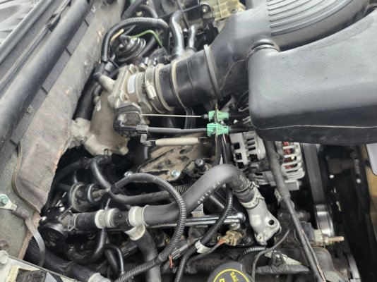

So I changed out the intake manifold and I think I put everything back where it is supposed to be. My short term memory is shot. So the top lines might be wrong. Can someone look at these pics and see if they are on right.

I'm struggling to follow the hoses, but I don't see any glaring issues with the routing. Any codes? Fuel pressure checked?

If it's running rough we can hope there are some codes. They don't all trigger the CEL and in some cases it takes a couple cycles of a code being seen before it will trigger the CEL.
The intake manifold as you are well aware requires removing and disconnecting quite a bit. You might consider getting ForScan and an OBDII adapter so you can read codes and do diagnostic testing. Things like air, fuel and fire can be looked at from the data available in ForScan.
Short of that all I can suggest is to go over everything to ensure it's connected. Though I kinda figure you already have, maybe more than once.
