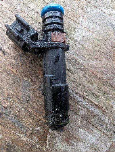

I have a 2006 EB 5.4 with 236000 miles. Running rough.Had diagnostics done at pep boys. Was told injector 4 was out and 1 5 and 6 intermittent.
Today I changed all injectors, coils, and mas.
Now runs very rough and throws a 113, 202,and 204 code. Could it be connectors? All injectors looked clean except #2 where should I look next?
