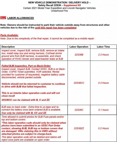

*Major Update* Standard Duty Final Repair Procedures Released. Dealer Recall response upgraded.
Highlights from the Dealer Bulletin (as cut-and-pasted text to hasten my providing this post)...
New! REASON FOR THIS SUPPLEMENT
• Updated technical instructions with complete repair and parts information (For Standard Duty).
• The Aux Box Wire Assembly will be made available in a seed stock program beginning week of July
18th, running through the month of August
• Updated rental guidelines to include pick-up and delivery, towing, alternative transportation, and mobile service
• Updated labor operation codes
• Updated claiming information
Ford Motor Company has developed a remedy for those vehicles equipped with a Standard-Duty Cooling Fan.
Final Repair Now Available:
Before demonstrating or delivering any new in-stock vehicles involved in this recall, dealers are to install the aux box wire assembly, and remove a ground wire from the BJB, also inspect the battery junction box (BJB) for damage, replace as required per the technical instructions. This service must be performed on all affected vehicles at no charge to the vehicle owner.
Ford Motor Company is working closely with its suppliers to produce parts for this repair. Until parts become available, Interim Battery Disconnect/Reconnect Service.

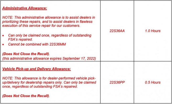

New! Administrative Allowance:
An administrative allowance of one hour is available to assist dealers in prioritizing these repairs, and create a flawless service experience for our customers (this administrative allowance expires September 17, 2022)

• Dealers are authorized to claim one-half labor hour per repair for vehicle pick-up and delivery services.
• Dealers must retain a Vehicle Pick-up and Delivery Record with the repair order documentation. Refer to the Claims Preparation and Submission section and Attachment IV for details.

Dealers will be notified via a DOES II communication if circumstances warrant a change in part supply strategy and when open ordering resumes.
Final Repair Procedures as single continuous image of all pages of official released document:
Standard Duty Cooling Fan vehicles... https://live.staticflickr.com/65535/52227945615_468276edef_o.jpg
Heavy Duty Cooling Fan vehicles... https://live.staticflickr.com/65535/52204414503_2c643b34d8_o.jpg
To download the image(s) to your local storage, with the image opened to full-width view in browser, right click on the image and select "Save image as..." in the resulting popup menu.
