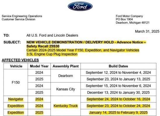

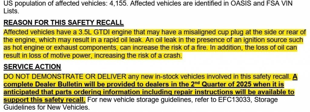

Please note: This Safety Recall information is being posted in the General Discussion forum to avoid duplicate posts, because the affected vehicles' model years span across the 4th Gen - 2018-2024 and the 5th Gen - 2025 to present forums.
*** This is an Advance Notice to Dealers. This post will be updated when the Full Notice to Dealers is released. ***
Safety Recall 25S30 - Advance Notice 1A.jpgSafety Recall 25S30 - Advance Notice 1B.jpg

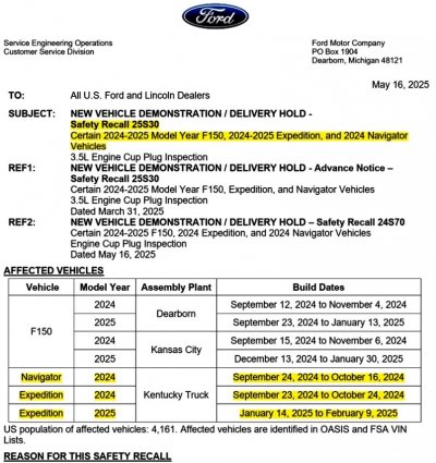

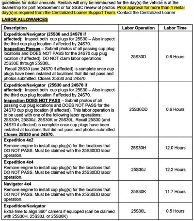

Ford has issued the Full Dealer Bulletin for Safety Recall 25S30, enabling dealers to proceed with repairs under this Field Service Action (FSA)...
View attachment 84787View attachment 84788View attachment 84789
For information on the referred-to Safety Recall 24S70, from which Safety Recall 25S30 has become the successor Field Service Action, please see...

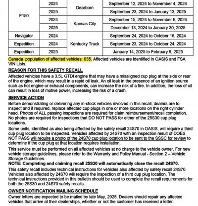

Confirming Ford of Canada's release of their Recall 25S30 Full Dealer Bulletin...
Safety Recall 25S30 - FoC Full Dealer Bulletin - Edit 1A.jpgSafety Recall 25S30 - FoC Full Dealer Bulletin - Edit 1B.jpg

So after my dealer ordered parts after the initial visit about 10 days ago (returned truck to me), they now determined they will need to pull the engine to complete the repair (they will get me a loaner). 2024 Expedition Max Limited SPP with only 4,000 miles, ugh.

Good luck - I would be worried it will never be right.
How many plastic clips, fasteners, connectors, etc. will be broken apart to remove the engine, and not replaced properly? The a/c system will be opened, plugged, then recharged. Will it be done right, without any moisture or contamination?
Chances are the mechanic will be racing to “beat the clock” on the time allowed for the repair.
