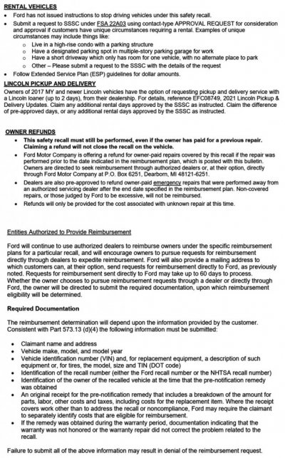

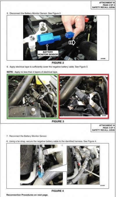

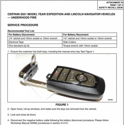

**UPDATE** Revised Dealer Notice, new Mobile Vehicle Repair recommendation for accomplishing Recall Service Action at Customer's home or business, new special-circumstance Rental Vehicle / Lincoln Pickup and Delivery provisions, Reimbursement procedure for prior Owner-paid Recall-related repairs, and full Recall Service Action procedure...

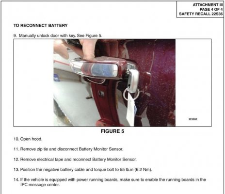

The 14-step service procedure seems to have an error or an unnecessary step.
Step 2 states to open the hood.
Steps 3 - 9 do not state to close the hood.
Step 10 states to open the hood.
