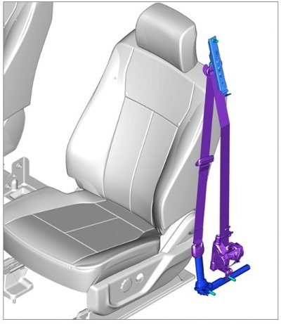

Seatbelt Anchor and Pretensioner
The seatbelt anchor pretensioner is a pyrotechnic device that removes excess of webbing slack from the seatbelts when deployed. One is included as part of each front row outboard seatbelt assembly and cannot be serviced separately.

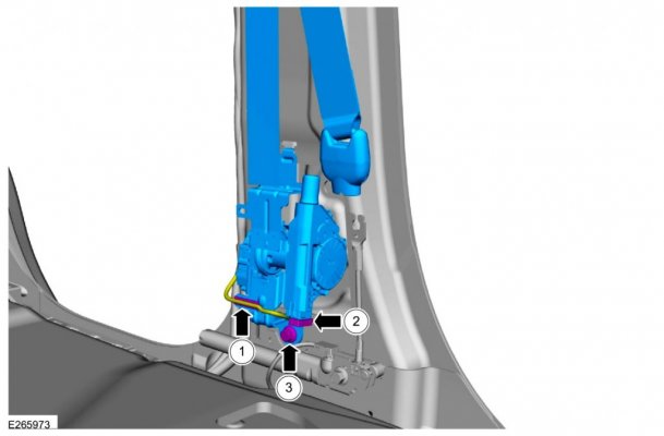

Seatbelt Retractor and Pretensioner
The seatbelt retractor and pretensioner is a pyrotechnic device that removes excess of webbing slack from the seatbelts when deployed. The retractor and pretensioner are serviced together with the front row outboard seatbelt assembly.
Seatbelt Retractor and Pretensioner - LH B-Pillar - 2018-2020 Expedition.jpg

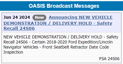

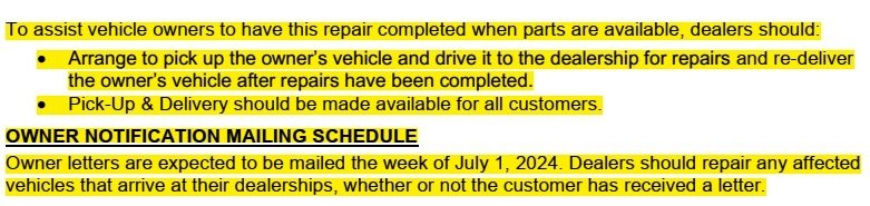

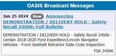

@Mr Big 's update is supremely timed because Ford's Safety Recall 24S06 Full Dealer Bulletin is just now available, though it's release has not yet been highlighted via Ford's Professional Technician System (PTS) website used by dealership Service personnel -- but this communication will likely occur on Monday, June 24th...

So the TSB clearly mentions the dealerships picking up vehicles and returning them to help customers get this done. I wonder if they will really do this and how far they will travel. It is a really big pain for me to get mine to the dealer and it was literally there last week ugh.

THEY DIDN'T PICK MINE UP
