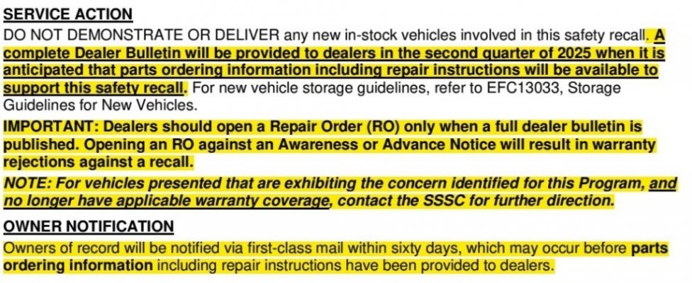

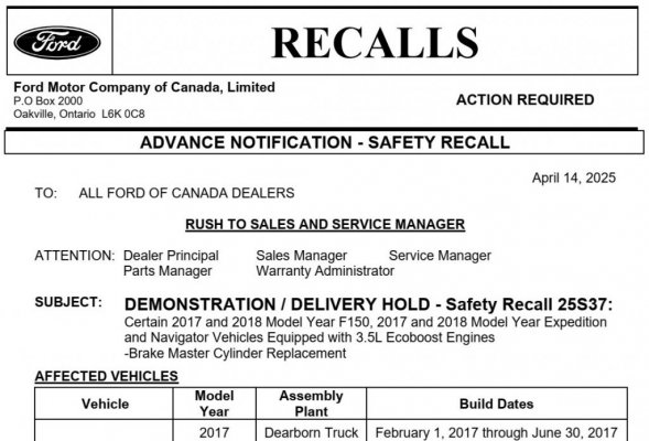

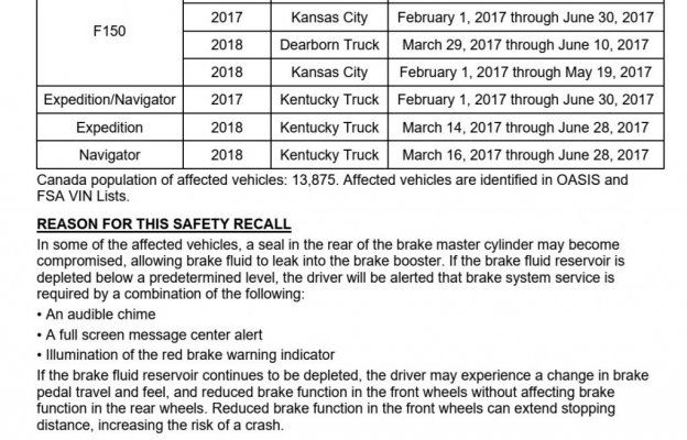

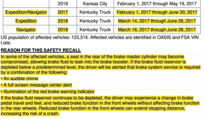

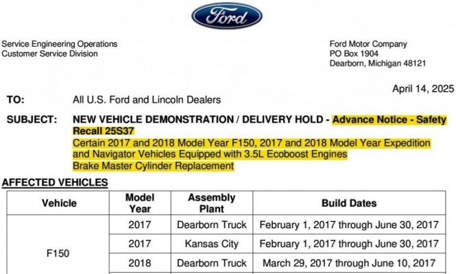

Safety Recall 25S37 - Certain 2017-2018 Expedition/Navigator + F-150 Vehicles Equipped with 3.5L EcoBoost Engine - Brake Master Cylinder Replacement

Just has the service completed at my Ford dealer last week. Master cylinder was in stock, had to order booster as brake fluid had gone into the booster. Took less than half of a day to fix.
