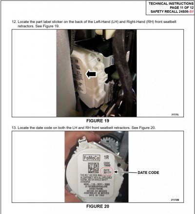

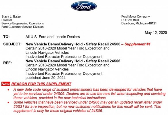

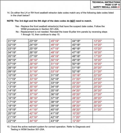

While the above-mentioned Safety Recall 25S31 remains an Advance Notice, Ford is issuing Supplement #1 for Safety Recall 24S06, which provides an expanded list of potentially-suspect component Date Codes, which in some cases may require some past-inspected vehicles to need re-inspection with these owners receiving an additional notification letter...

My driver's side was replaced when my pretensioner exploded before the recall.
I reported the incident after the repair was done and Ford implemented the 1st recall. They then replaced my passenger side, after I received the warning light. This was after I received the recall, but had to wait for parts. They determined the AC drain hose that was missing was the problem. Water leaked into the vehicle causing connections to get wet and corroded. The recall also called for the hose to be installed.
Now I see this new recall. My vehicle is at Ford today, for the recall for the Catalytic converter module update programming. I asked them about this recall, and they said I would have to make another appointment, because there's a chance the parts used to replace the driver's side have been updated.
