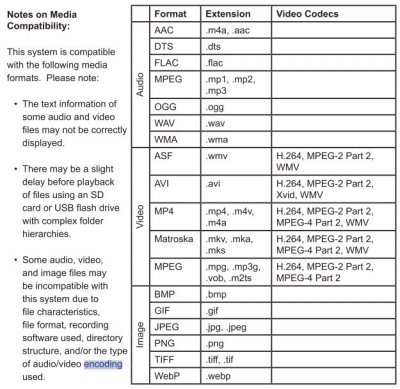

Fizzy - I'm running into the same issue. I'll review the manual again to see what changes need to be made with the encoding.
Do you recall your encoding settings? I'm using Handbrake.
techdude99
Nov 25, 2019
367
140
US
OK, I found this in the manual and will try again tomorrow.

That's the table I was thinking of. There's another table that lists compatible resolutions and aspect ratios too I think.

It's very unlikely to be in a codec that the RSE system understands.
You should grab HandBrake (free software) and convert it to one of the extensions and codecs in that table. It should work then.
