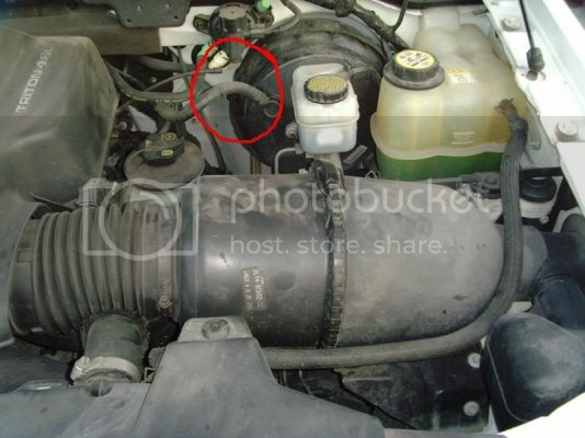

^ LOL yea, that is a somewhat older picture. Now there is a CAI in place of the stock one, but it's still just as dirty :p
I usually never get around to it, partially because I'm always afraid water is going to get somewhere that it's not supposed to.

I did the Seafoam thing yesterday. I put it in the same place, brake booster line. After blowing all the smoke out, just about closed down the freeway, it seemed to run much smoother. I put half a can in the fuel tank, the other half through the engine.

I just let the truck idle, and i placed the brake booster line into the can of seafoam. It sucked the can dry in very short order and I could not stall the truck! I just shut the truck off after it emptied the 1st can. I let the truck sit for about 45 minutes while I took apart the air cleaner and cleaned the throttle body and MAF. After I put it all back together, I poured 1/2 a can of seafoam into my oil, and the other 1/2 into the fuel tank. Starting the truck up after letting the seafoam sit in the top end of the engine - it runs really rough! That's why you need to 'fire it up' and head down the street - to blow all the stuff out of the engine. This stuff will really smoke up the 'hood! Mine looked like I was fogging for mosquitos! REALLY heavy white smoke. After running the truck (read: heavy foot, 1st & 2nd gear) the exhaust smoke cleaned up after 4-5 minutes and the truck runs smoothly. I changed the oil in my truck two weeks after adding the seafoam. I haven't seen any adverse effects with adding it to my oil or running it through the top end. Seems to run better from the stop sign....
