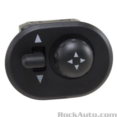

The side mirror issue may be as simple as a faulty switch or just dirty contacts in the switch. Worst case if spraying it out with electrical contact cleaner doesn't fix it you can replace the switch for about $40 from Rock Auto. http://www.rockauto.com/en/catalog/...cal-switch+&+relay,outside+mirror+switch,4572
Just use a putty knife to pry/release the switch from it's hole.
