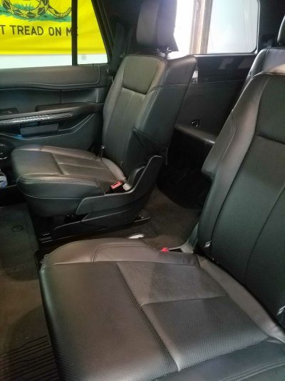

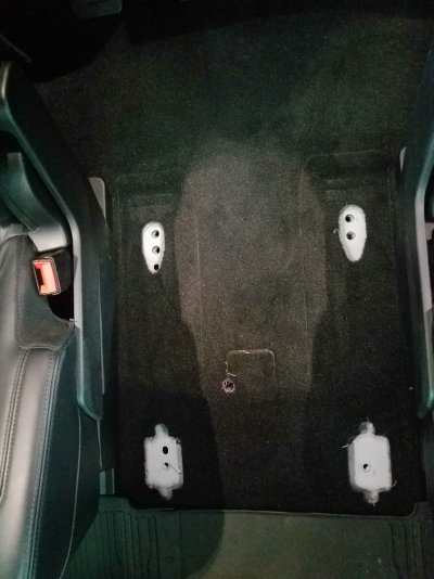

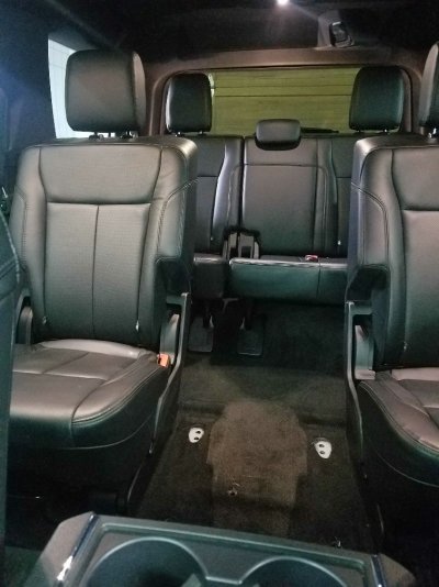

I just deleted the center seat in my 2018 xlt.
Now what do i do about these darn holes.
Wondering if Ford or anybody sells something to cover them up.431ccb05826576f7a0b421c34199403d.jpg49a1caffd6200b9c4d932e10e0d338e9.jpg242a1d7d5d4573f447c26b8b0b4d354a.jpg

Measure the size and buy some plastic plugs. Then put a bucket seat floor mat over them

Gadsden flag.... I like this guy.

If you add the 2nd/3rd row floor matt(s) from Weathertech it will cover up that area.
It looks like the carpet is sculpted out where the tracks would have been, so a floor mat is going to pucker unless the low spots are leveled out. The Expy's with Captain's chairs from the factory don't have the sculpted out area in the carpet between the seats.

im guessing that area in the center is where the wire for the power folding comes from. Appears the wire tucks back in well?

I would find some carpet to match or see if some can be cut from under the front or rear seats that will not be noticed and cut plugs to fit.
Make them a little larger and then you can tape or glue them into place after final trimming.
If you work the edges around with a stiff brush or fairly pointed pick etc you can blend to where it will not be noticeable.

I would do a combination of TobyU and Fozzy and cut out patches in similar carpet, larger than the bare spots, tuck it under the factory carpet and then get the plugs Fozzy shows (a little longer because of the thickness of the carpet) and make a small slice and insert the plugs through the carpet patches into the bolt hole.
Stops patch from moving and protects bolt hole threads.

Thread button head bolts in the threaded holes and buy plugs like posted earlier in the others.
Then buy the floor liner of your choice that is for the captains chairs.
Take a heat gun and form the floor liner to the hump and you’ll be just fine.

Meh, I wouldn’t bother plugging the holes or worrying about the slight divot. I’d just throw down the WeatherTech one-piece 2nd/3rd row liner to cover it and call it good. Makes it a little faster/easier if you want to put the center seat back in.
