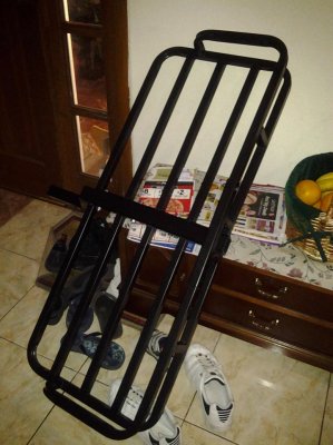

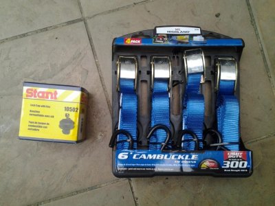

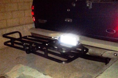

got the stanton lock gas cap today. fits works great - we'll see how long it lasts.
got some cambuckle cables, pretty good quality
got a hitch cargo carrier, kinda disappointed with some of the spot welds and also one hole isn't aligned for the bolt. but it looks pretty decent for the price.
all courtesy of amazon.
