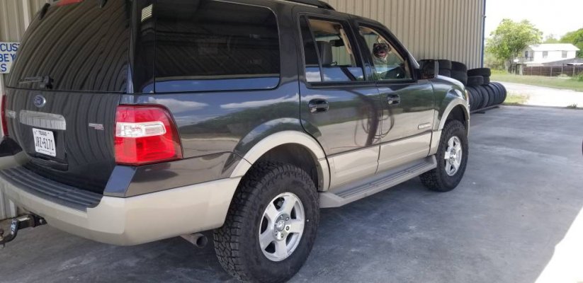

I have 9" wide 0mm offset wheels and want to run 35x12.50r20 tires.
I have the Traxda 2.75"/ 2.25" spacer lift kit.
I do think you will have rubbing with a 35/12.5 with most offsets. If you don’t have outside you might have inside, but there is a bit of trimming you can do there.

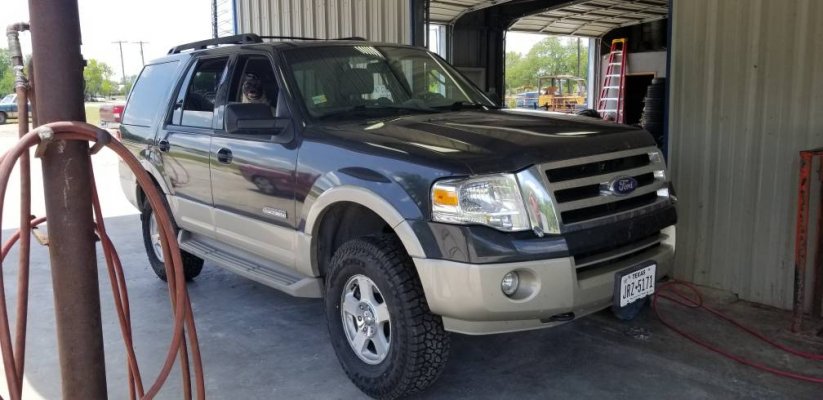

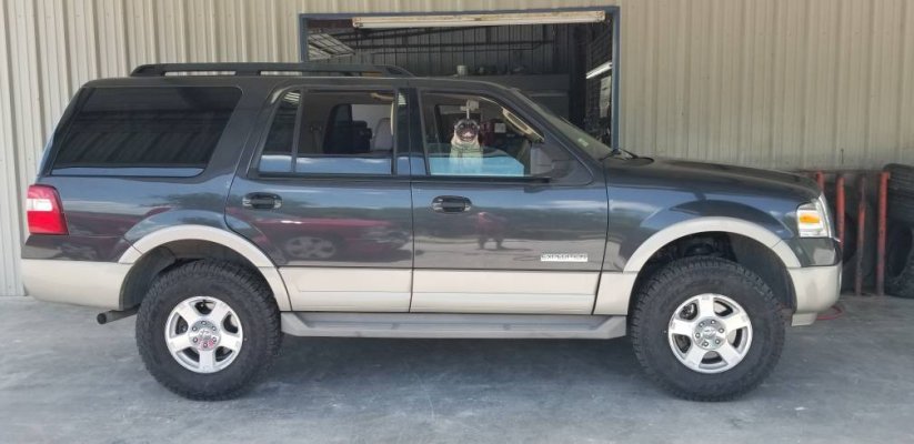

Mine is a 2010 King Ranch w/ power running boards.
If you're running 11.50 width tires on a +44mm (+1.73 inches) stock offset, doesnt it seem like the 0mm offset would more than make up for an extra 0.5" width on either side of the tire?
Plus... x12.50 wide tires are usually between 11.6"-12" actual width...

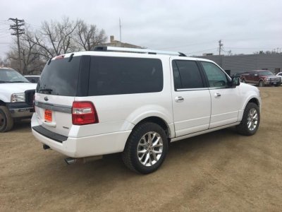

Be careful. If it is a Platinum with 22’s it most likely has CCD. Stick with a limited with 20’s with the heavy tow pack and load leveling and you have the perfect combo. That is what I have and have been very happy.

Nice! Like them in White! @ExpeditionAndy has one a lot like that.
The 22’s ride terrible without the CCD in my opinion, but if you lift and put a little more rubber on them, might be as good as factory 20’s.
