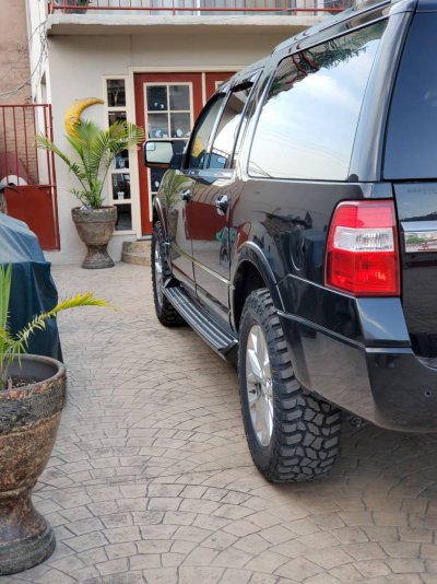

Hi Everyone. This is my first post ever. I have been studying this thread for several weeks as I wanted to give my 2014 Expedition EL Limited a facelift. After much thought, I got the Ready Lift 1.5" Leveling Kit. My truck has the Mechanical Rear Load Leveling Suspension and I didn't want to mess around with those Nivomat shocks so I left it alone. I had the 20" chrome clad wheels professionally sanded, painted, and clear coated. At that time, I also had everything blacked out that was chrome except for the door handles. The tires are BFG All-Terrain KO2s sized at 305/55R20. I thought I would share the current look since I got so much inspiration here. Thanks!

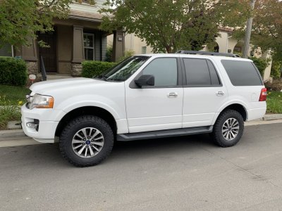

Nice. What lift do you have? Or is it all shock? I like the tires, too.
I’m guessing 5100s up front and either stock with a Readylift spacer or 4600s with spacer for the rear. Can’t put 5100s on the rear and can’t top the 5100s up front with any type of spacer

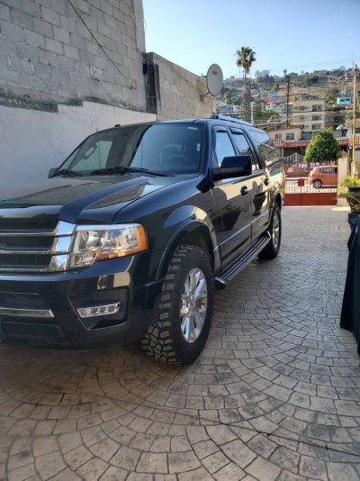

5100s front and rear.. No spacers... that's what they gave me at 4 wheel parts..
2 different item number front 24-285056
Rear 24-285053. Once they installed the new tires the back looks at least 1inch taller... have to go back to see if it could be adjusted to have it level...
