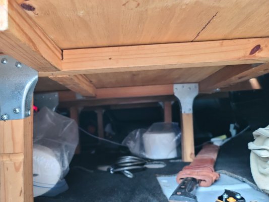

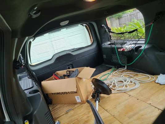

I took out the 2nd & 3rd rows. DIY wooden platform. Cut so I can optionally reinstall one or both of the outside 2nd row seats. Walmart queen size mattress toppers, trimmed to fit wheel wells. Queen size sheets. This rig sleeps two comfortably on multiple weeks long trips.20230515_100013.jpg20230515_100028.jpg

I took out the 2nd & 3rd rows. DIY wooden platform. Cut so I can optionally reinstall one or both of the outside 2nd row seats. Walmart queen size mattress toppers, trimmed to fit wheel wells. Queen size sheets. This rig sleeps two comfortably on multiple weeks long trips.View attachment 77683View attachment 77684
Nice, looks like a lot of space with bunches of headroom. Did you only go to the level of the rear where the flip-up door hides the jack and tools? Did that stop you from installing drawers or was that all the space you needed? Looks like a great space for batteries, solar controller, inverter, etc. as well as a loadout for a backpack. Thanks for the picks.

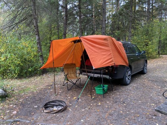

Do you have a link to this canopy or did you make it yourself from various pieces?
It's just a 12 x 9.5 tarp that I've draped over the back and secured with varying lengths of bungee cords. It's primitive but gives plenty of coverage from wind/rain and packs up/deploys pretty fast. The two tarp poles I use on the end are super helpful if there are no trees around.
