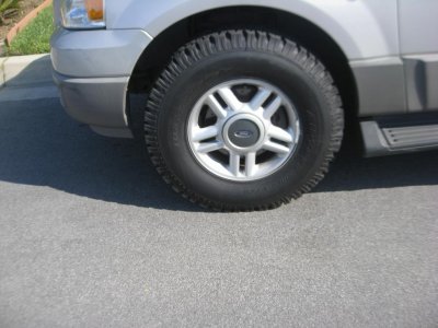

the tires and factory rims that you are running look great together. is the pic of the 285/70/17? did you have any issue with rubbing when at stock height with out lift?

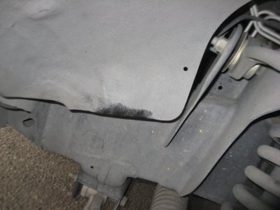

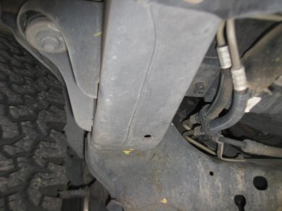

yes all the pics have 285/70/17. i had some rubbing when turning on the inner fender liner. all pics are 285/70/17 on stock rim stock height. BUt mine is a 4x4 which is about an inch taller than 4x2.
1. front tire
2. rear tire
3. where tire rubs on inner fender
4. tire rubbing on inner fender
5. side view

that looks great i had an 93 explorer that had the same tires not same size but love how it fills the wheel well. was the rubbing an issue? damage anything at all?

not an issue just an annoyance of hearing it rub. as you can see the only "damage" was the black mark left of the inner fender. the only thing that i did was i wouldn't turn the wheel to full lock when turning so i wouldn't hear the rub. Backing up and turning was the worst because as the "tire knobs" where going up into the fender liner instead of just rubbing down against it.
