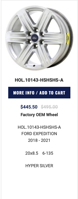

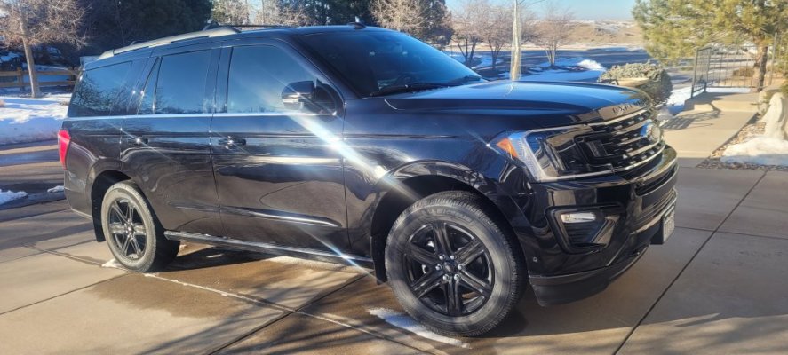

I used Detroit Wheel and tire to get 20s that fit an EXPY and no worries with the axle lengths. They clearly state what part numbers work for EXPYs. I got these in black but they come in silver too. They also have a price match policy you can read about, I used it and ended up getting the wheels for $1,140 all in for a set 4 of freshly powder coated wheels.
On my 20s I have a new set of Michelin Defender LTX MS2. Awesome tires, ran the first LTX version on 4Runner and Jeep GC 12-15 years ago. Had the Pirellis as stock on the 22s that came on the vehicle and Michelin is better all around tire and has a 70K warranty. Got them at Discount Tire.

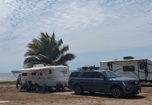

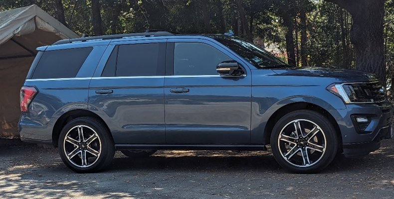

I too went from the 22's that came with my '19 Stealth to some F150 take-off 18's, and am totally happy with them. yes, I had to slice 1/4" or so off the ends of the rear axles.
the original 22's...
18's
18's deep in Mexico (at a beach campground near Teacapan), 8000 miles into a 10000 mile 4 month camping trip.
