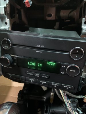

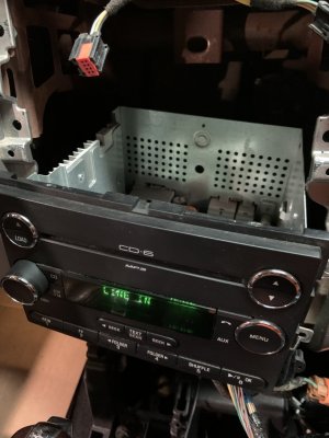

82B353B5-65F4-4DA3-9B76-BF5C41D02662.jpeg 7ACC8E57-52BD-4015-9A2E-E0ED7ECBFEDF.jpeg Know this is a year old, but wanted to add that someone had done to this one same as what I’m doing today to mine. Simply removed the 6 disc changer drive to stop it from trying to eject a ghost disc. When ever I unlock the doors with the keyless or turn the ignition on, the stereo would cycle through 4 attempts to load or eject a cd. So today I took the cover off the top of the head unit to discover there aren’t any disc in it. I’m guessing it was jammed and previous owner forced the disc out. The slots aren’t evenly spaced apart. Looks like it was playing disc 3 and is frozen there. I looked for ways to reset it back but would require a major disassembly. I wondered what would happen if I plugged the head unit back into the truck with the changer left out. It seems to operate like normal with the exception of displaying CD ERROR for a second if you press the LOAD button. I’m totally happy with that. But I’m installing the changer back in just leaving the ribbon cable unplugged. I don’t want to risk objects especially something metal pushed into the center slot and frying the main circuit board.
