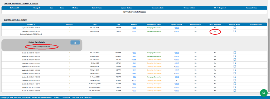

You have two active OTA's in queue, but the truck is not pinging the server back to accept them. OTA dashboard shows auto updates is off. Have you given permission for the OTA to install on the touchscreen? In your case, the truck has not downloaded anything. The OTA needs consent to try to install like the ones in June. That one does show it installed successfully. Once that one installed, the "nag screen" came back because there was another OTA waiting to install right after it. Give it permission, and the TCU will mostly likely go first. After that, the APIM update will queue up and that is the one everyone is having issues with.
I do have auto-updates off. I'll be home tomorrow to try it out, so is it best to connect to wifi and leave it running while it does the updates? thanks again.

The update installed successfully. You had one install yesterday and another one today.
What is interesting to me is this TCU OTA. I had never seen a direct config only OTA sent to any Expo/Navi until now. I had mentioned earlier that wifi is not necessary because 99% of OTA's download through the modem. Well, say hello to the 1%. That TCU update is one of the very VERY rare OTA's that actually do require wifi.
