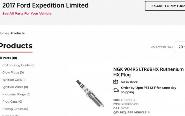

Well.....I went to the NGK web site and they indicate I need this plug # for my 2017 Expedition.
Correct. Heat Range. The one they list on the site is one heat range warmer than what I mentioned above. It is well documented the 3.5TT Ecoboost motors like 1 Heat Range cooler than what ford puts in them. The 6 in the middle is the heat range of the plug. The one I recommended is a 7, and in NGK speak, that is one range "Cooler". I have been working with EcoBoost Motors since late 2015. As you can see in my signature, I have owned several, including both a 2015 Expedition, and 2017. Even stock I have seen benefits from the colder plugs. Smoother idle being one of them. The one listed below is what many tuners recommend, even when not tuned. Several here have switched to them, and seen benefit. Do your own research.
