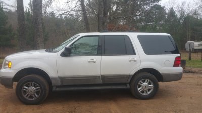

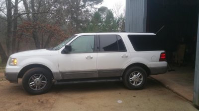

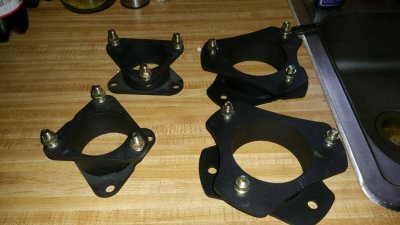

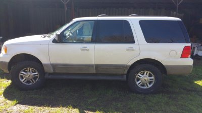

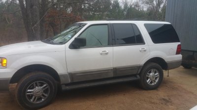

adding pics so you can see the progression(i know not same angle, but i hope gives you idea of the amount of lift)
1. original
2. with 285/70/17 stock height
3. with front 3.5in lift installed
4. with with 3.5 front and 2.5 rear

Tallsville, what's the deal with rotating the strut 180 degrees? That's what my instructions told me to do
tallsville
tallsville
Jul 10, 2009
3,176
170
LA
i dont remember my instructions telling me that. But a 180 degree turn would not work. there are 3 studs 120 degrees apart. So if turned 180 it wouldn't line up with the bolt holes.
