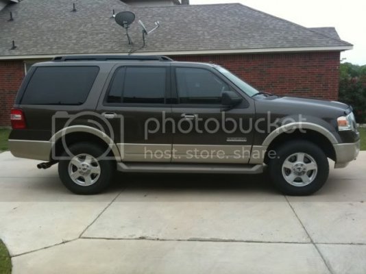

Wylie, Texas
Noticable???
Before lift
After Truxxx 3/2
Will be even better once I put the right tires underneath, sigh...
