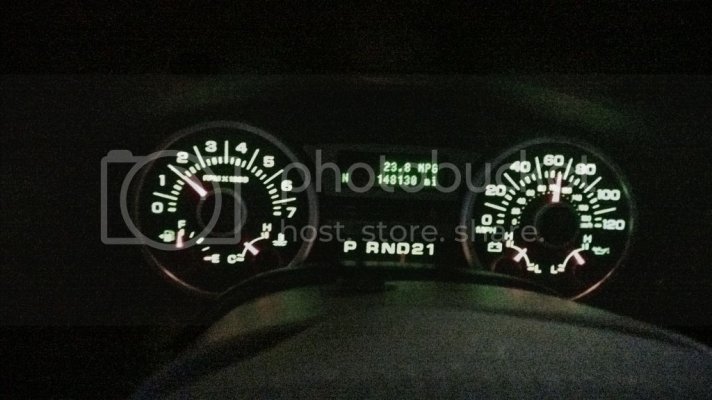

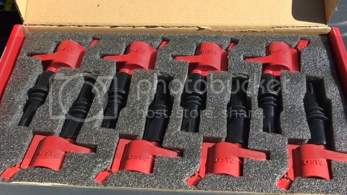

I just changed mine at 146K. None broke. Used carb cleaner, seafoam and about 5 hours to do it myself. Used E3 plugs that I bought 3 years ago. I have no clue how long these will last, based on what I've read on the net. Also swapped out the old COP's with MSD COP's, just because Autozone brand would be way more expensive.
Best MPG that I get is around 23 on the highway. Wife still manages 10.8MPG average per gas tank.

No real advantage is changing COPs that are working fine. A set of boots and connectors is $30-35 for 8.
