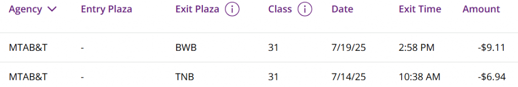

Check your EZ-Pass account when you get a chance. I have 4 EZ-Pass between mine and my kids cars. One of them died after multiple years. If they read your plate linked to your account the charge for Throgs Neck and Whitestone is $9.11 but if it reads transponder it's $6.94. Varies for other places also as well as out of state.
Next hassle is trying to replace. You can only have 4 on each personal account so need to claim the bad one lost. They charge you $16 for a replacement. Once you get the new you send the bad one back as found and they credit. At that point they "supposedly" will look back 6 months and credit the difference of plate vs. transponder on account.
I'm currently waiting 1 month for the replacement version. I called EZPass customer service and lady said multiple customers waiting over 2 months and still not shipped out. How hard can that be?
First post here, not a troll, same name on multiple forums. Looking at Expedition as short list for replacement for my wife's Pilot. UV coating issue came up on another forum so searched internet to here.
Yea. We had a similar thing it’s not for every toll, it typically is if you have a discount, it won’t get applied.
