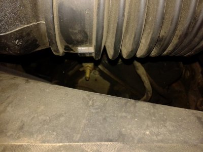

So after the mechanic changed my oil professionally he noticed that there was significant water in my exhaust.
There was a code but it turned out to be low voltage to the abs.
These pictures are of my valve covers.
The mechanic said that the exhaust should be repaired before going through water again. I want to also do spark plugs and improve battery connection in addition to the valve cover gasket and fuel filter.
