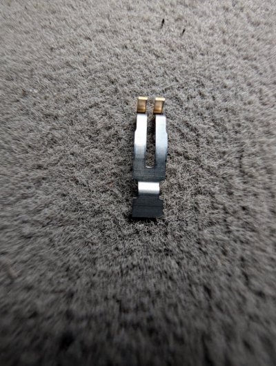

I pulled the steering column out of my 2004 Expedition to remove the dash so I could replace the heater core. That was lots of fun. Only problem is these two clips fell out of the steering column I think from the bottom side and I'm not sure what they are or where they go back. Anybody know what these are?

I'm almost certain that's the same clip someone had an issue with recently in this thread. There's pics with location of where it goes.

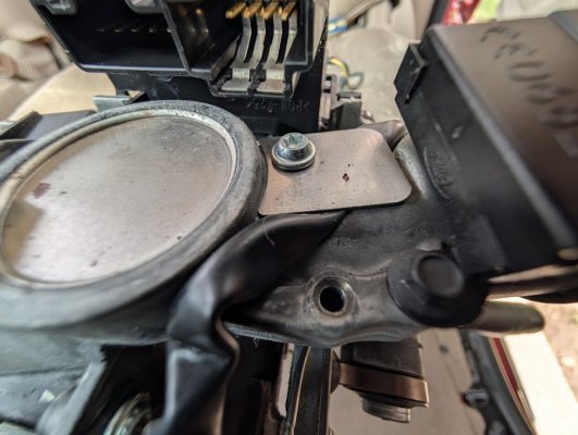

Thanks. They were on the right track in that thread, they do go in the receiver for the gray plug. PXL_20250531_203910252.jpg
