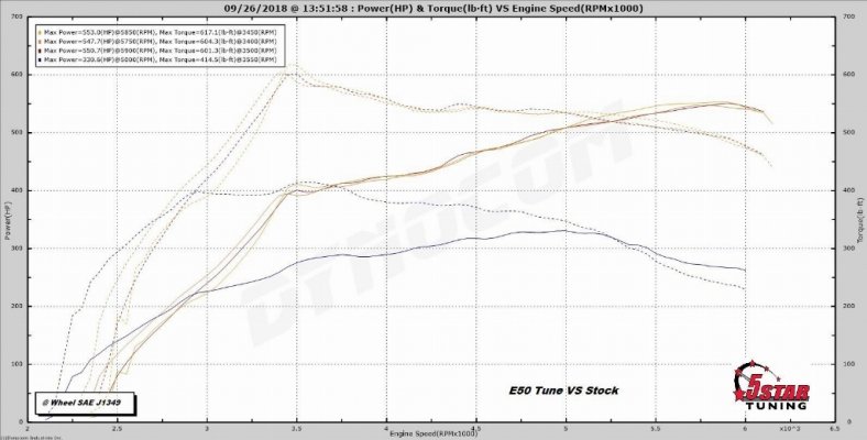

Have tried the E30 & E50 tunes in my 2018 EXPY & 2018 F150 3.5L ECOBOOST
They flat haul with those tunes :burnout:
Been averaging 19.2 MPG with the E30 Tune in the EXPY with E51 Flex Fuel
5 Star got 553 Wheel HP & 617 LB FT Torque with a 3.5L GEN II E50 tuned F150
That would be about 675 CS HP & 750 LB FT CS Torque
Chart Below

For the e30 tune on Expedition, what model, 2 or 4WD, and what gears?
Hi All
My 4wd EXPY has the HD Tow package with 3:73 rear axle
Throttle opening is delayed somewhat with factory calibration
Throttle response nearly instantaneous with 5 star calibration:33:
