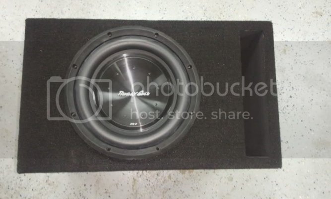

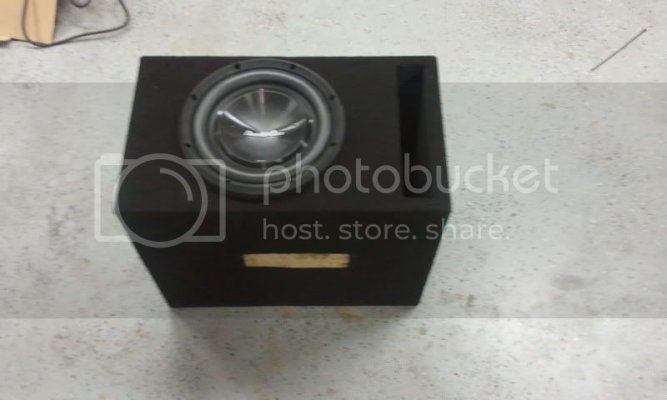

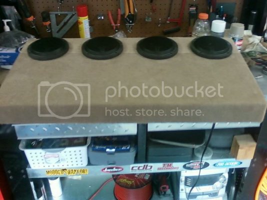

Here is the way I do it and have done it for 12 years.
I choose my wood based off the subs I'm building the enclosure on.
Cut my pieces according to the cut sheet.
Lay everything out
I use a finish nailer with 16 ga finish nails instead of screws. they range from 1 3/4 to 1 1/2 depending on the thickness of the wood. I use Elmers wood glue or titebond. glue the pieces and nail them together. Before i nail the top on the box i go back and calk the seams together. Then I cut the opening for the woofer and buzz off any shiners (nails that popped out of the wood). I then spraythe enclosure and the carpet with contact cement and wrap the enclosure.
Here are a few pics.
