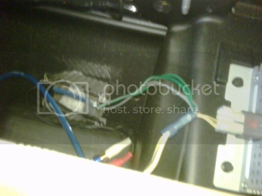

It is probably not necessary to follow the repair manual instructions and remove all the panels, which is what I dit at first and a lot of work. To confirm what I have read elsewhere, the subwoofer amp can be accessed by removing the rear tray on top of the side panel (driver side). Pop out the cup holder if you need access to the wiring feeding the amplifier. I also installed a on/off switch in the 12 volt line feeding the amplifier so I can turn the sub off if the rear passengers complain about sitting too close to the subwoofer. The sub is great for the front seat passengers, but very annoying for the rear seat folks. I reinstalled the side panels and then replaced the amplifier so I know this works.
