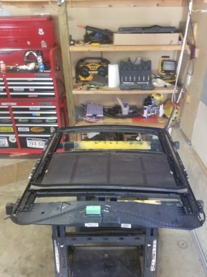

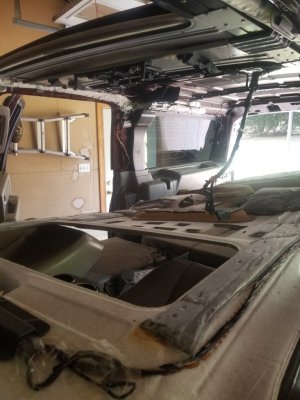

Just did mine a couple weeks ago...took about 10 hrs, had to remove DVD player and all seat belts..there is a re initialization process for the sunroof motor once reinstalled. Parts were only 120 bucks..Sucks but way better than 2500 quoted by the stealership.20190803_165133.jpg 20190803_165147.jpg 20190803_171303.jpg Good Luck!

Where are the seats? Did you have to pull them?
Did you happen to notice where the drain lines run to?

Just did mine a couple weeks ago...took about 10 hrs, had to remove DVD player and all seat belts..there is a re initialization process for the sunroof motor once reinstalled. Parts were only 120 bucks..Sucks but way better than 2500 quoted by the stealership.View attachment 31704 View attachment 31705 View attachment 31706 Good Luck!
Oh, hell no. After seeing these photos, I am certain I would set the truck ablaze before embarking on this project.
The seats are in full recline. It's part of the suggested process for dropping the headliner.
