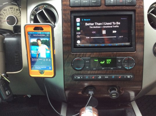

Agree!
I used Crutchfield and did exactly what you desscribed above. You do loose the remote controlling of the rear entertainment system but it will continue to work manually with headphones. This wasn't a concern for me because I never used it. And when grand kids use it they like the headphones.
