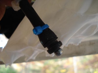

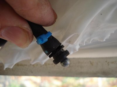

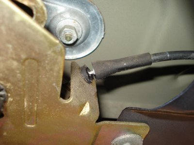

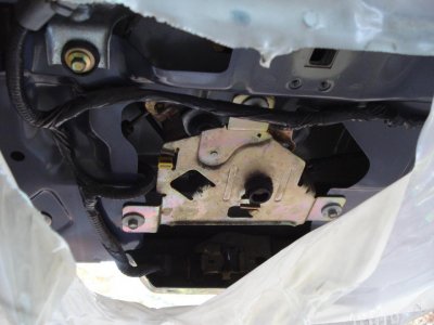

It's a 2000 XLT. As you can see once you take the plastic off and get in there good ole ford decided it would be in there best interest and ours to use these cheap rubber pieces. The rubber has cracked, causing it to have no tension in the line. I need to think up something to create that gap again.
Any ideas?

The same thing happened to my parent's 250. The Super cab door wouldn't open any more. My dad ended up just cutting a slit further up in the plastic, and using that as the new neck.
